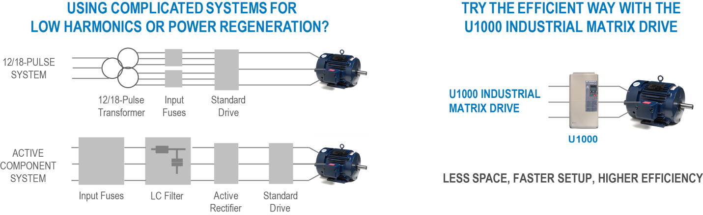

Unlike conventional drives, the drive has nine bi-directional switches in a matrix to convert a three-phase ac input voltage directly into a three-phase ac output. So, there’s no rectifying circuit or dc smoothing circuit as in traditional ac drive “inverters” … which makes for reduced harmonic distortion.
More specifically, when a conventional ac drive converts power, it distorts the input current and degrades power quality. Matrix technology reduces total harmonic distortion levels to 5%, without the need for reactors and filters. The result is a smoother current waveform that reduces stress on the system power supply and infrastructure. Less distortion also boosts the power factor … and cuts energy costs.
The compact drive can also regenerate power without additional components. Traditional drives utilize regenerative braking resistors to dissipate energy as heat, and that degrades efficiency. In contrast, the U1000 Industrial Matrix drive returns regenerative energy directly to the power supply, increasing energy efficiency and saving money.
