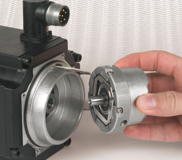

Bandwidth (relative to command response and control reliability) can be limited by the rigidity of the coupling between the motor shaft and encoder shaft as well as by the natural frequency of the coupling. Encoders are qualified to operate within a specified acceleration range. Values typically range from 55 to 2,000 Hz. However, if the application or poor mounting cause long-lasting resonant vibration, it will limit performance and possibly damage the encoder.
Natural frequencies vary depending on the stator coupling design. This frequency needs to be as high as possible for optimal performance.
The key is to ensure that the bearing of the encoder and the bearing of the motor are as close to perfect alignment as possible. Figure 4 shows an example of how this is accomplished. The matching tapers of the motor shaft and encoder ensures near perfect alignment to the centerline.
This mechanical configuration will result in a holding torque approximately four times greater than a standard hollow shaft encoder with a 2-mounting tab stator coupling, as shown in Figure 5. This will increase the bearing life of the encoder and provide exceptional natural frequency and acceleration properties. Additionally, this configuration will virtually eliminate any limits on the bandwidth of the drive!
