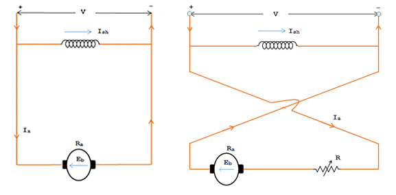

Plugging — sometimes referred to as “reverse current braking” — is possible on both DC motors and AC induction motors. For DC motors, plugging is achieved by reversing the polarity of the armature voltage. When this happens, the back EMF voltage no longer opposes the supply voltage. Instead, the back EMF and the supply voltage work in the same direction, opposing the motor’s rotation and causing it to come to a near-instant stop. The reverse current produced by the combined supply voltage and back EMF is extremely high, so resistance is placed in the circuit to limit the current.

When the motor speed reaches zero, if it is not disconnected from the supply, it will begin to reverse, or rotate in the opposite direction. In some applications, reversal of the motor’s direction is the goal. But when plugging is used to brake the motor, a zero-speed switch or plugging contactor is used to disconnect the motor from the supply when its speed reaches zero.
One of the potential problems with plugging as a braking method (especially when the braking time is short) is that it can be difficult to brake the motor at exactly zero speed. Another drawback to plugging is that it can induce high mechanical shock loads on the motor and connected equipment, due to the abrupt stop that it causes. Plugging is also a very inefficient method of stopping and, therefore, generates significant heat.
