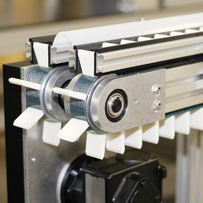

When accurate product location and orientation is required, timing belt conveyors are typically the best choice.
Also referred to as synchronous or toothed belts, timing belts have toothed surfaces that engage with matching, toothed pulleys. This positive engagement between belt and pulley, together with pre-tension (force applied to the belt in the direction of motion) eliminates the problem of belt slipping. And timing belt conveyors typically use belts that are reinforced with steel or Kevlar tensile cords to provide increased load carrying capability and enable high acceleration rates (which result in high forces on the belt) without causing the belt to stretch.
To improve grip, the top (carrier) side of the belt can be coated to increase friction between the product and the belt surface and reduce the possibility of the product slipping on the belt. Belt and pulley materials and finishes can also be selected to meet specific application requirements and environmental conditions, such as ESD-compatible, food-grade, or clean environments.
When application requirements call for a very accurate product location with no loss of position, cleats or fixtures can be attached to the belt carrier surface to hold the product in a specific location and with the correct orientation.
Another option to ensure precise location and orientation is to transport the product on a pallet. Locating the product on a fixed pallet, together with the accurate, no-slip conveying of the timing belt, provides the highest level of position accuracy and certainty.
