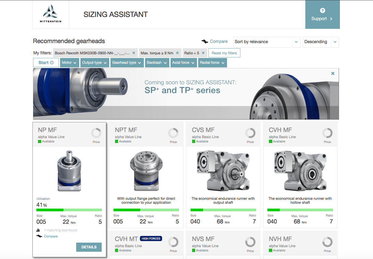

Wittenstein (alpha) Sizing Assistant
The first step in using Wittenstein’s Sizing Assistant is to decide whether you want to perform the gearbox selection based on the application data or on the motor being used. When “application data” is selected as the input criteria, the user enters the application’s maximum torque and chooses from pre-defined motion cycles (profiles) and operating time. The gear ratio is also entered manually, and the program provides a graphical list of gearbox that meet these criteria.
Filters such as output type, gearbox type, maximum backlash, and radial and axial loads help to narrow the possible options. A nice feature of the options list is that each gearbox also shows a “utilization” percentage, which essentially indicates how much of the torque capability is required by the application (considering the service factor).
Using “motor” as the input criteria only requires selecting the motor manufacturer and model from drop-down lists and manually entering the desired gear ratio. Again, a list of suitable gearboxes is shown graphically, and filters can be used to narrow the choices. Wittenstein’s software also lets the user compare gearboxes in a side-by-side list.
Once a gearbox is selected, the software provides download options for CAD files and data sheets, as well as the option to request a quote.
