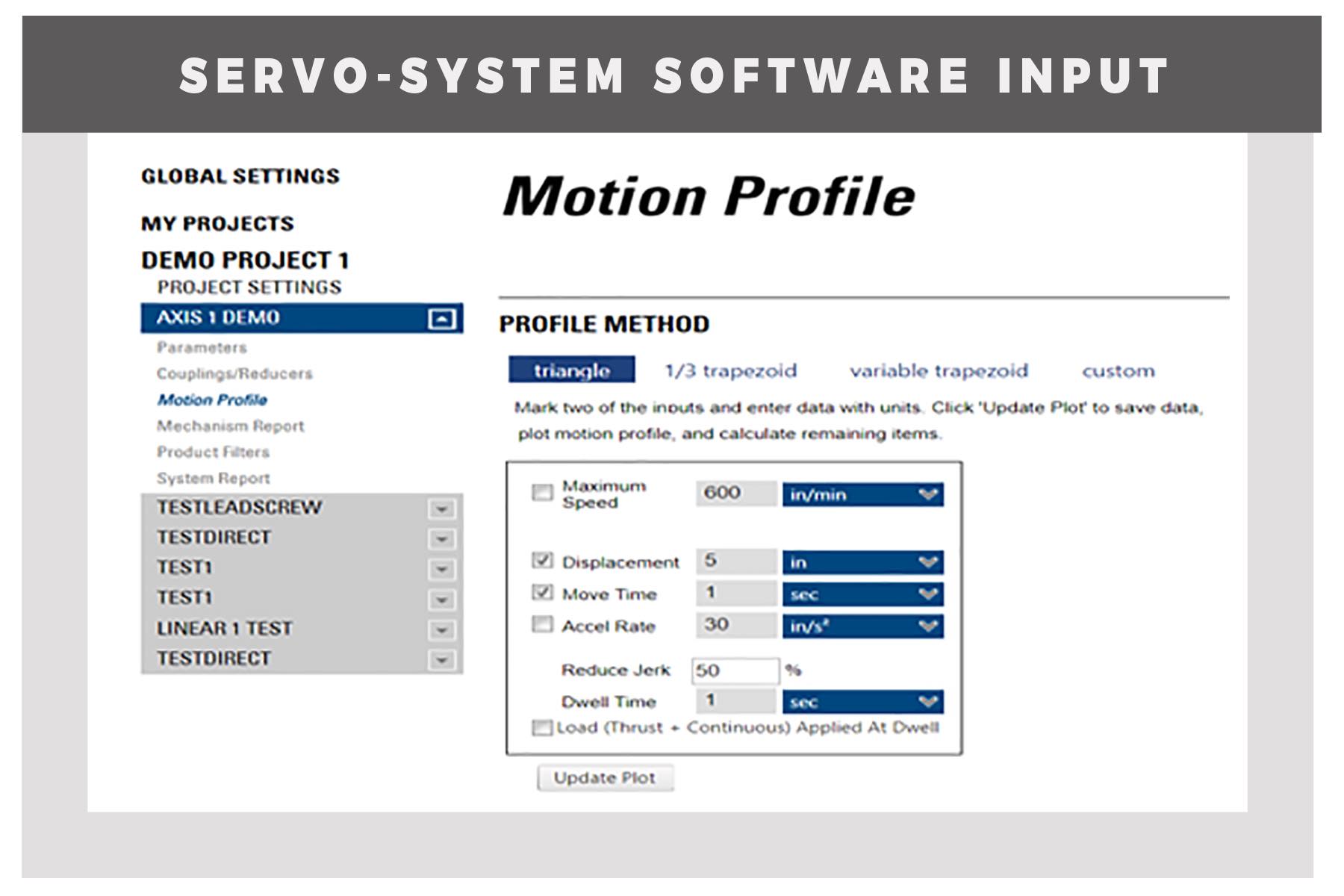

Today’s sizing and selection tools help design engineers build out motion profiles based on the motion requirements of the application. Some manufacturers’ software tools also let design engineers describe moves in different ways … and then assist in calculations of acceleration rates, move times and distances, and traverse and dwell times.
Consider a classic motion-profile example — a basic 1/3-1/3-1/3 profile with the introduction of 50% jerk to smooth out the acceleration rates. Assume we choose to move eight inches in one second using 50% jerk and a dwell of two seconds. Software then calculates the move assuming 1/3 of the time is spent accelerating, 1/3 is spent at traverse, and the last 1/3 on deceleration.
Maximum speed is calculated by our software tool at 720 in/min. Refer to the actual software screen captures illustrating this feature, and note the S-curve profile based on the 50% jerk rate. For this move, also note the thrust load (plotted as a red line) applied during the traverse portion of the move — the portion of this move profile during which machining takes place. The dwell period runs this out to the three-second mark. (This dwell portion is quite important, as all parameters related to this profile ultimately go into calculation of the RMS torque — the one measure we use in selecting the correct motor.)

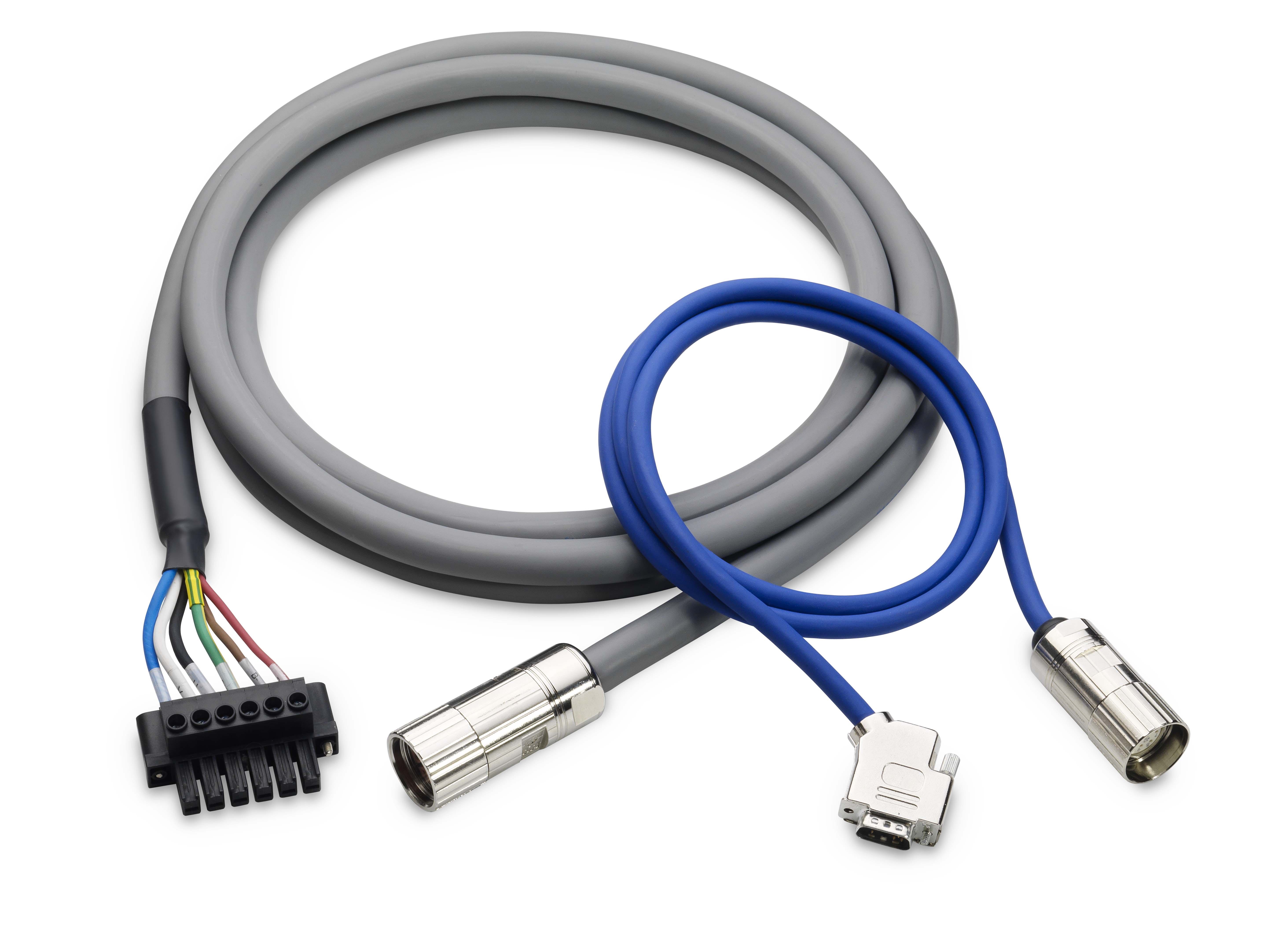

We’ve talked a bit about the servo motor and servo drive, but cabling between the two is important as well. Cable flexibility as defined by its allowable bend radii is a key consideration here — especially where the cable travels with the axis.
Cable length may be limited by the type of feedback device considered. Cable parameters such as impedance and voltage drop (along with the feedback device’s signal strength) dictate suitable cable length. Some newer devices available on the market are transmitting serial information to the drive (such as DSL, EnDat, and BiSS protocols) at very high transmission rates which again are affected by length, specifically impedance and signal to noise ratios.
In fact, even connectors play a role in the feedback loop, as connectors must handle the kinds of signals being generated from these feedback devices. Another consideration related to the motor power that dictates allowable cable length is that of high switching frequencies from today’s PWM drives. Noise from this switching is always present in the motor power cable, and as the cable gets longer and reaches a half wavelength of the frequency riding on the cable, an antenna is created. Antennas like to transmit and receive information, and in this case, it’s noise … which isn’t desirable in high-performance systems.
