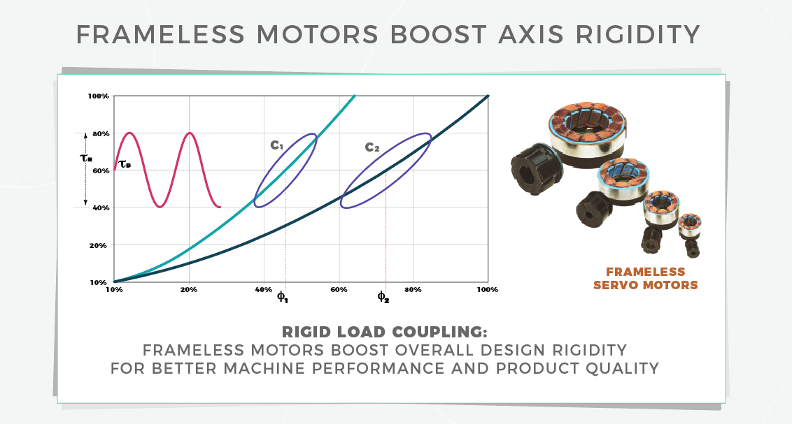

One major advantage of frameless motors is extremely high stiffness. Of course, a design’s overall stiffness depends on that of all its components. Traditional designs include a motor with a shaft coupled to mechanical transmission components like belts and pulleys, lead screws, or gearboxes. Even shaft stiffness can have a significant effect on system stability — as it’s a function of diameter cubed.
Frameless torque motors offer don’t need the transmission components with their attendant lost motion and stability issues. The result is output-transmission stiffness that’s sometimes dozens of times more torsionally stiff than traditional motor outputs.
