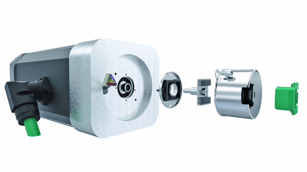

Absolute encoders, which report the shaft’s rotary position, excel on critical positioning axes. These come in self-contained versions (having their own closed housing and shaft) or kit forms. Here’s the difference:
• Self-contained encoders require some form of coupler to connect them to the motor’s shaft.
• In contrast, kit or modular encoders are integrated by the machine builder into a motor or drive mechanism to measure rotary motion directly from the drive shaft. These kit encoders might be built into the motor’s housing or attached externally to the motor’s end bell.
Absolute magnetic encoders, which measure rotations through a set of Hall-effect sensors, are a top option for feedback control of stepper motors. Available in self-contained as well as kit form, they are rugged and relatively insensitive to dust, moisture, and other contaminates … plus are easy to install. Magnetic encoders that take kit form consist of an electronics package (mounted on a small PCB) along with a small permanent-magnet array attached to the rotating shaft. Miniature versions of these encoders in self-contained form (having external diameters down to 22 mm) are available for especially small motors.
