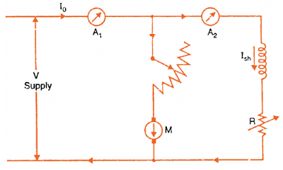

The Swinburne test is an indirect method for determining the efficiency of DC motors. It works by finding the no-load losses experimentally and then estimating additional losses from the rated motor data. From this information, the efficiency can be determined at any applied load.
First, the no-load current and shunt field current are obtained directly via ammeters when running the motor with no load, at its rated speed and with the rated supply voltage. The no-load current is measured and denoted Io, and the shunt current is measured and denoted Ish.
Input voltage: V
No-load current: Io (obtained via measurement)
Shunt field current: Ish (obtained via measurement)
No-load input power to motor: Po = V*Io (1)
Image credit: studyelectrical.com
The no-load armature current is found by subtracting the shunt field current from the no-load supply current.
No-load armature current: Iao = Io – Ish (2)
