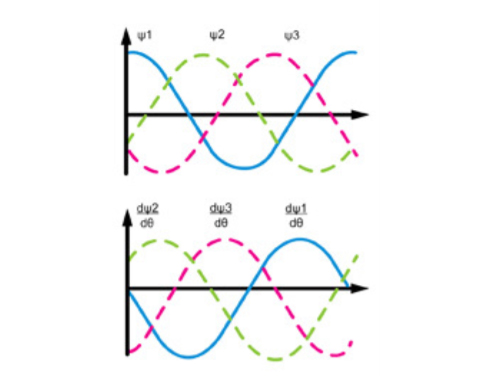

Back EMF (electromotive force) is a voltage generated by the rotation of the motor. It opposes the applied voltage, according to Lenz’s Law, and reduces the current flowing through the coils. Back EMF will generally be sinusoidal if the power supply is AC and trapezoidal if the power supply is DC.
The stator of a BLAC motor (also referred to as a permanent magnet synchronous motor, or PMSM) has skewed magnets and overlapped windings that are sinusoidally distributed, which results in a sinusoidal back EMF waveform. The drive current, being AC, is sinusoidal in nature and closely matches the back EMF waveform. The combination of three-phase sinusoidal drive current and sinusoidal back EMF results in a very constant torque output, with virtually zero torque ripple. Sinusoidal waveforms also give BLAC motors high efficiency and minimal noise and vibration when compared to motors with trapezoidal current and back EMF.
Sinusoidally wound motors can use sinusoidal commutation, in which a Hall sensor or feedback device is used to determine the rotor position and apply the correct commutation sequence. The goal of sinusoidal commutation is to generate a rotating current vector that has constant magnitude and is orthogonal, or perpendicular to, the rotor. (Recall that a vector has both magnitude and direction.) In order to do this, the rotor position must be determined with a high level of resolution, so resolvers or encoders are used more often than Hall sensors for rotor position detection.
