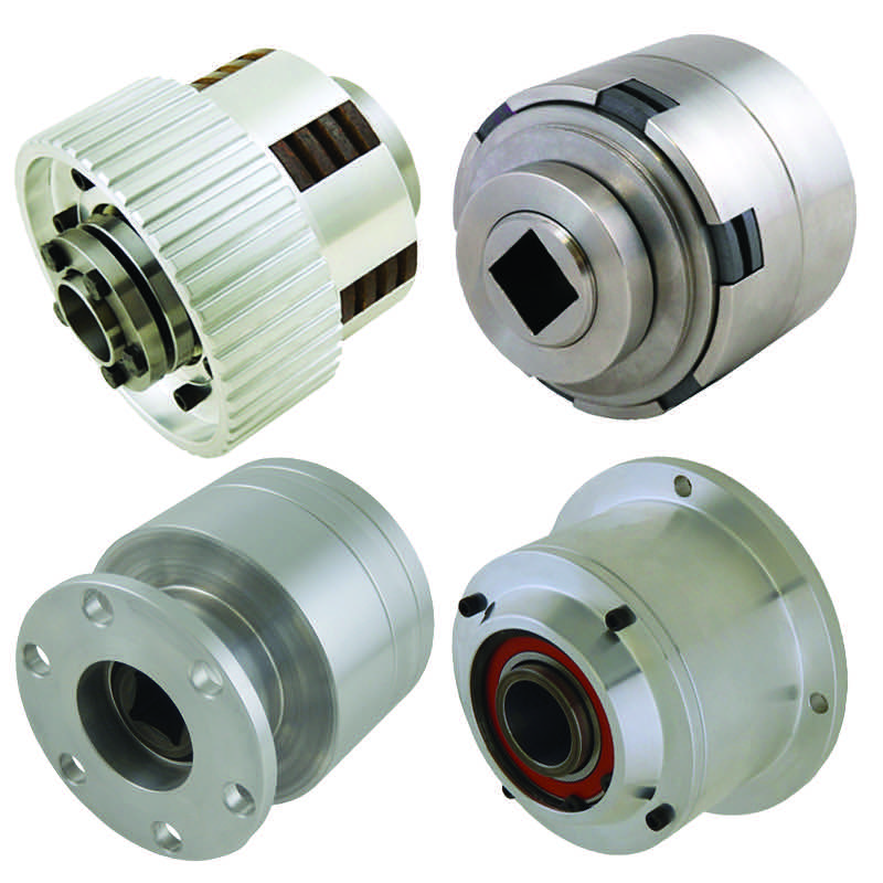

Key parameters dictate which clutches and brakes are suitable for a given application: The first parameter is the mode of motion and whether the axis needs a brake or clutch. Clutches generally bridge moving machine sections to shape relative motion, while brakes’ main job is to stop and hold rotating elements. Several design variations exist, and a main differentiating factor is the way in which a brake or clutch engages. Some options include mechanical, electric, fluidic, or self-actuation.
Brakes and clutches using fluid-power actuation usually include a piston to physically engage friction discs for torque transmission from an input to an output. Hydraulically and pneumatically actuated clutches and brakes are quick-response units that act on fluid pressure and piston mass, so engagement speed follows control pressure.
Some air-actuated brake and clutch designs are specifically designed to run coolly … and maintain hold with minimal power.
Some caveats though: In many clutches, full piston force transmits through a bearing — effectively a wear point — to let the body rotate as the housing stays put. Here, the bearings and high loads also limit operating speed. Brakes using fluid-power actuation don’t need such bearings.

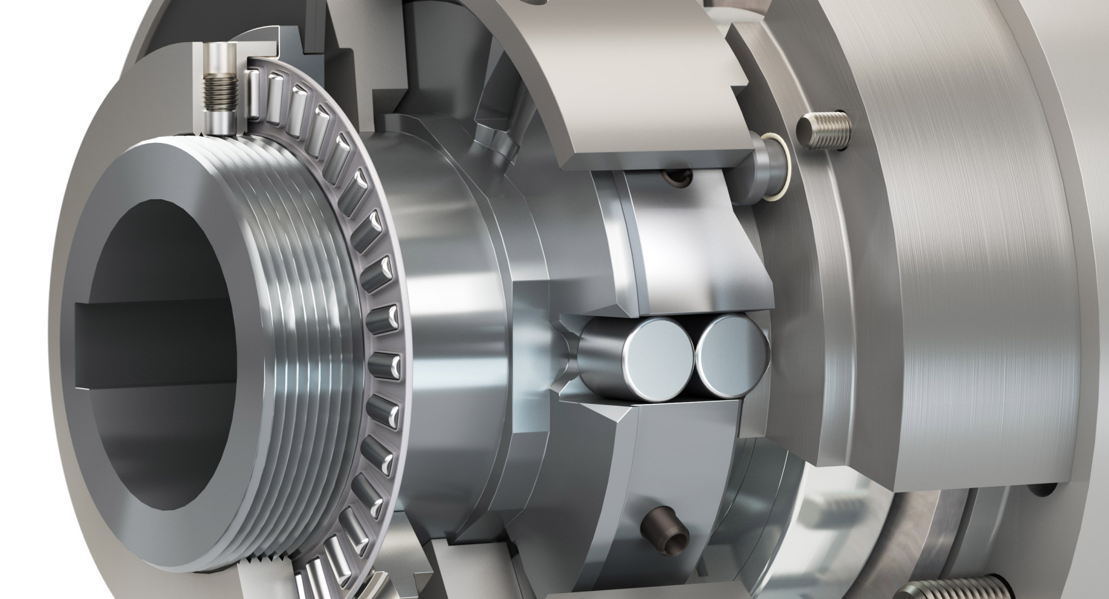

Brakes and clutches using mechanical actuation include a lever for mechanical advantage to trigger engagement and disengagement. This levering usually works to squeeze friction discs together for torque transmission. When the mechanism moves, the clutch or brake condition changes from engaged to disengaged or vice versa. Some such brakes and clutches have a locking mechanism to keep the unit as it is until repowering. Such clutches and brakes have no bearings to fail; are fairly speed tolerant; come in optional one-position setups; are unaffected by power failures; and offer automatic overload release during over-torqueing or locking. On the other hand, many mechanically actuated clutches and brakes don’t automatically disengage during power loss — and most need adjustments to compensate for wear.
Clutches and brakes that are electromagnetically engaged (or disengaged, depending on design) use a magnetic coil to generate a magnetic flux — either to move an armature from friction-disc contact or to move the armature for squeezing discs together. That’s because electromagnetic clutches and brakes are either electrically activated or spring-applied-electrically-deactivated setups. The latter does double-duty as a failsafe during power loss.
Electric brakes are easy to control and cycle, even to a couple thousand cycles per minute.
Electromagnetic clutches and brakes are high-speed tolerant; exhibit long life; and come with self-adjustment mechanisms to compensate for friction-disc wear. But there are drawbacks with this technology too: They need bearings to support a stationary coil — and the bearings bear a light load from the radial flux-path use. What’s more, electromagnetic clutch or brake engagement time exceeds that of other designs due to the time needed to generate the coil’s magnetic field.
Clutches and brakes called wet-running units contain fluid to work by the effects of a transmission-fluid boundary layer. More specifically, fluid shears between friction discs and drive plates. As the parts come together, the fluid in shear transmits torque. This eliminates direct friction-disc contact during high-speed slip. Just note that oil shear generates heat even in neutral; there’s oil shear until the in and output are almost to equal rpm.
But in applications that must rapidly stop, start, reverse, and change speed, clutch brakes that use oil-shear technology excel. Heat from the friction dissipates as the fluid circulates to the housing. That’s useful on axes with start-stop cycles or cycle rates to high-cycle setups (to 300 cycles per minute, as a rule of thumb). Here, oil-shear brakes last five to ten times longer than dry clutch-brake offerings. (Just review the application before specification to prevent heat from becoming an issue.)

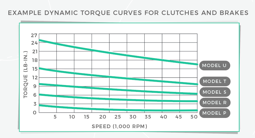

Dynamic torque depends on the rpm delta between in and output (for a clutch) and operating and zero rpm for a brake. Dynamic torque is usually about 50 to 80% of static torque. In friction-based designs, this value depends on the contact surfaces’ friction coefficient. Because that changes slightly (with the portion of operation the brake or clutch is delivering) designers usually employ an average coefficient for design calculations.
Note that it’s usually best to size brakes and clutches to the machine axis’ motor torque. But for axes where the brake must stop vertical loads, engineers must account for how motors can temporarily draw higher current to output more than rated torque. Refer to published performance curves from brake and clutch manufacturers to get dynamic torque ratings for operating-speed ranges to properly match brakes and clutches to the axis’ motor output torque.
Designing a dynamic clutch or brake application
Recall that once there’s relative motion in the assembly, the brake or clutch torque capacity falls. Ultimately the value — called dynamic torque — depends on the relative speed difference.
